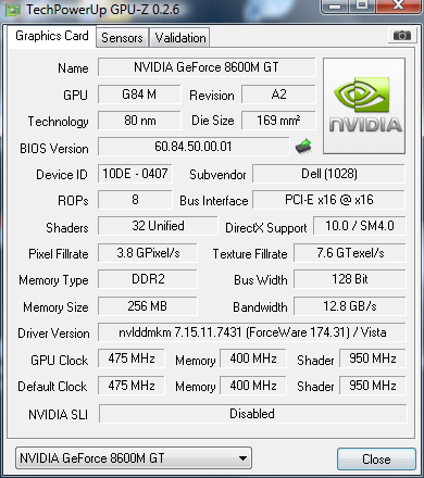

So I dig deeper..I downloading 3dmark, GPU-Z, and CPU-Z. First thing I notice is my 3dmarks are 1.5k when other 1720s are getting 3-4k on their tests (even with somewhat lower stats )
So then I run GPU-Z and CPU-Z and the only difference I could find from other 1720s is that the 8600M GT I had was running at PCI-E X1 not the maximum the card (and motherboard) can handle which is X16.
*the imageshack pic is from another 1720 who ran GPU-Z

Also I ask if anyone else has a 1720 with 8600m GT, If they could take a screen of their results so i can show dell more proof that this card is not suppose to be like this!.

Good pics they help. The thing that caught my eye is your card has an older BIOS, why not flash it to a newer one?

Here is mine.
